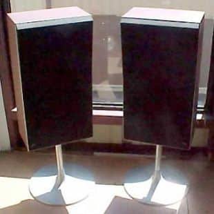

Top of the range monitor speaker, these were much more like the Beovox S60 than the Beovox M75 that replaced them. They were 4 way speakers with the tweeter and midrange level with each other and the Phase link and woofer below. They could be fitted with the dramatic trumpet stand and were the sp [...]
They were 4 way speakers with the tweeter and midrange level with each other and the Phase link and woofer below. They could be fitted with the dramatic trumpet stand and were the speakers specified for the Beosystem 6000.
Type Number: 6304
Release Date: 1975, 1976, 1977, 1978, 1979
Designer: Jacob Jensen
Colour / Finish: Rosewood, Teak
Continuous load 70 W
Music load 120 W
Impedance: 4 – 8 ohms
Frequency response: +4 -8 dB 27 – 20,000Hz
Sensitivity: 5 W
Gross volume: 39.1 litre
Woofer: 25 cm
Phase link unit:12.5 cm
Mid-range unit: 2.5 cm
Tweeter
Dimensions W x H x D: 35 x 65 x 29 cm
Weight 25 kg
