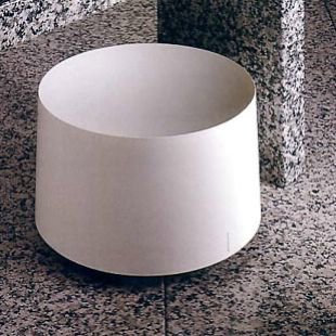

By using smaller loudspeakers in the Bang & Olufsen range – like the BeoVox CX50 or BeoVox C75 passive speakers, all it took to fill out the sound even more was the BeoVox Cona, a passive sub-woofer. Beovox Cona functioned almost like a prompter who ensured that the sound didn’t forget its ‘l [...]
Beovox Cona functioned almost like a prompter who ensured that the sound didn’t forget its ‘lines’. It worked on the principle that the human ear cannot detect in which direction deep tones are coming from. Beovox Cona, like the newer BeoLab 2, could therefore be placed anywhere in a room with the rest of the music system to give it a deeper, much richer sound.

Visually, the BeoVox Cona generates several comments. First off, one notices the size, very large for a single driver, especially that of 8 inches. This quality quickly earned the title “ottoman” by my girlfriend. So far I have not found a corner the Cona could not squeeze into, so it is a very practical size. They are very subtle but can also retain a good focal point in a modernly appointed room. The roundness of the Cona is a nice departure from the cubic trend of standalone subwoofers we are all used to seeing. I like to maintain the idea that the form of the Cona also serves a function. Coming from the same time period that gave us the Penta and Red Line speakers, I believe that the Cona followed a common trend set by the Penta and Red Line speakers in utilizing a unique cabinet shape to reduce internal acoustic reflections and standing waves by removing parallel surfaces from the construction.
