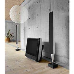

There are three placement options – a stand (with optional shelf for DVD 1 or Beocord V8000 – as in above picture), a motorised floor stand and a motorised base. It also has its own in-built stand to tilt back the set (as in BeoVision MX4000/4002).
