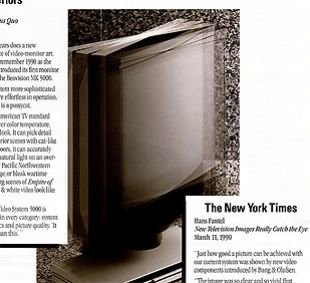

Bang & Olufsen’s first television in the North American market was a variant of the European MX range with important changes to accomodate the different electrical and broadcast systems there.
