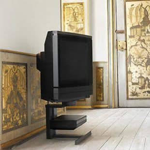

The last word in a fine story, the MX4200 looked modern at its introduction despite being modelled on an 18 year old design. A testament to the vision of David Lewis. Beovision MX4200 is a 52cm 4:3 television set, and is based on an updated chassis of Beovision MX4000/4002. It has the same design [...]
Beovision MX4200 is a 52cm 4:3 television set, and is based on an updated chassis of Beovision MX4000/4002. It has the same design line as the previous MX model range but includes the following improvements:
Improved picture quality
16:9 format handling
Set-Top Box Controller as standard
Camcorder connection
Theft protection
MasterLink module (optional)
RF Modulator (optional)
Part numbers for Beovision MX4200:
MX4200 1813123 1813122 1813124 1813125
MX4200 with MasterLink 1813083 1813082 1813084 1813085
MX4200 with ML & RF Modulator 1813103 1813102 1813104 1813105
Motorised Wall Bracket 1408966
