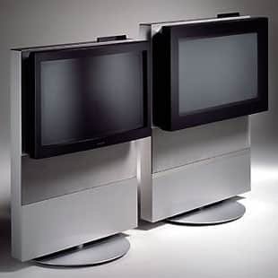

The BeoVision Avant gives you a television that acts like a picture on the wall: a wall you personally position in the room. It has a built-in video which is invisible to the viewer. Everything is operated via the Beo4 remote control. You have full control from the best seat in the living room, and the television turns towards the viewer using the motorised base.
BeoVision Avant – designed by David Lewis – was a totally new concept from Bang & Olufsen and was introduced in 1995. This video system is completely integrated holding a widescreen television, a hi-fi stereo VCR and a couple of active speakers in its attractive-looking cabinet. It was also the first wide-screen TV from Bang & Olufsen ever. Although by the end of the twentieth-century widescreen TVs were taking more and more market share, most TVs still used the 4:3 format. When Bang & Olufsen started planning for this model they originally envisaged to use the same technology then currently used in the MX series but along the way they decided to develop a completely new chassis. This new chassis is much more advanced.
The Avant is also a very environment-friendly TV using a lot of recycled material as well being recyclable itself at the end of its serviceable life. The set can also be expanded with several add-ons. For example: picture-in-picture (PIP), satellite receiver and Dolby Pro-Logic or Dolby Digital decoder. The Avant is the pathway to the future of video systems; a whole new concept of the most advanced video system from Bang & Olufsen to date.
The widescreen format 16:9 picture tube is used for the first time in the BeoVision Avant. This created conflict between designer David Lewis and Bang & Olufsen’s technicians, as the designer could not see the point of it. A new picture tube that could not be filled by the TV picture. Where randomly placed grey stripes on the picture tube were a part of the framing of the picture most of the time. The technicians did not think it could be their fault. Wide format 16:9 was an attempt to consolidate a whole industry around a new market standard. The designer’s talk of trimming and stretching the picture to fill out the frame was, in their eyes, simply distortion. There was no ideal solution to the dilemma.
Together they had to find the solution that would work best in practice. It was not possible to fill the 16:9 format with a 4:3 TV picture. The necessary trimming and stretching annoyed the eye too much. On the other hand, wide format had a lower limit. In the eyes of designer David Lewis, that lower limit lay in the 14:9 format. The technicians struggled to implement the format with as little distortion as possible. They also checked to see whether designer David Lewis would notice the difference if the format was a little bit smaller. Just a few millimetres smaller on the longer element! But David Lewis saw it straight away. There was a distinct limit in the eye’s perception of the transition to wide format, and it lay at 14:9.
Finally, they managed to come up with a method that could handle the problem satisfactorily in practice. A method that has subsequently been further developed to implement the 15:9 format that is close to the aesthetic ideal: the golden rectangle. Programmes recorded and distributed in 16:9 are the ideal way of filling the wide format, but the range is still limited. Bang & Olufsen’s wide-format TV offers a practical solution to filling the screen with ordinary TV and video programmes. It was created by trained eyes.

Its standard features were: VisionClear Technology and multi-format picture. It houses a 16:9 widescreen television with automatic picture adaptation, which means that every broadcast, no matter where it originates, is automatically shown with the optimum reproduction, from news reports in standard format, to movies in widescreen.
BeoVision Avant features the same functions as Beosystem AV 9000. When you turn it on, first it turns on its motorised stand toward your favourite watching-place. Then comes the sound, produced by four active loudspeakers hidden directly underneath the widescreen, while behind the black curtain the picture adapts to its format and to the lighting conditions in the room, before the curtains glide aside and reveal a perfect picture.
BeoVision Avant encourages you to lose yourself in a sound and picture experience – and not in the technology. That’s why we hang the 16:9 Real Flat wide-screen on its own smooth wall and conceal everything else behind it – including a set of speakers that will outpace the average hi-fi and a video recorder that tunes itself automatically.
You can choose a built-in DVD player or video tape recorder and from a range of five colours. There’s also the option of a simplified 66cm version with no integrated entertainment source.
Design
Close your eyes and imagine the perfect TV. Open them again and take a look at BeoVision Avant. It’s a widescreen TV that’s easy to understand, effortless to use and always a pleasure to watch.
Though a widescreen TV is never going to be small in size, it doesn’t mean that it has to dominate its surroundings. The Avant has a subtle presence and comes in a range of colours that allow it to compliment any environment in which it’s placed.
At Bang & Olufsen, it is taken for granted that when you watch TV, you want to concentrate on the experience rather than on the technology. That’s why the Real Flat screen is ‘hung’ on its own “wall” with everything else concealed behind.
Widescreen
The picture quality provided by the Avant is as close to the real thing as you can get. Its smooth Real Flat widescreen provides the perfect format for movie watching – and together with the exceptional sound creates a spatial illusion that’s second to none.
Switch on the Avant and it automatically adjusts any broadcast to the optimal widescreen picture – no matter what format it was produced in. News and sports broadcasts are expanded from the traditional 4:3 format into 15:9, while movies shot in widescreen are reproduced in a 16:9 format that’s as close to the original cinema version as you can get. And, if you don’t like the picture as it is, you can easily change to another format with the Beo4 remote control.

Features
Watching movies should be about simple entertainment, not complicated technology. That’s why the Avant is available with its own built-in DVD player or video recorder. Its presence is only given away by a discreet lid on the front. All cables are hidden in the back of the set.
To ensure even greater viewing comfort, the Avant has its own motorised stand that turns effortlessly through a 70 degree arc. You can program it to turn automatically towards your favourite viewing chair, or use the Beo4 to turn it in the opposite direction. When you switch the Avant off again, it returns silently to its original position in line with your furniture.
A red LED display on top of the cabinet gives you a discreet status of the source you are viewing, without intruding on the picture. It also shows the volume status when you adjust the volume level, and other information related to recording, Dolby Surround and so on. On the back of the display is a hidden push button panel for the most frequently used controls.
The Beo4 remote control is used to access all the various functions of video-playback and recording, menus, tuning, text-television, picture optimisation, sound properties and so on. Beo4 is designed for user-friendly and ergonomical operation with one hand. The buttons in a star-shape for search, ultra-sharp still-picture, super slow-motion, programme shift and fast forward can be controlled by your thumb only, you don’t even have to move your eyes. Beo4 also controls all the latest B&O audio systems as well – it’s the key to complete home entertainment!
A discreet display on the upper right hand corner of the Avant lets you know what source is playing and a small control panel placed behind it offers hands-on control of all basic functions.
This television became the basis for renewed efforts in the US television market which has been overall successful.

Type Number: 8423
Release Date: 1995, 1996, 1997, 1998, 1999, 2000, 2001, 2002, 2003, 2004, 2005, 2006
Designer: David Lewis
Colour / Finish: Blue, Black, Silver, Green, Red
Dimensions W x H x D / Weight:
84 x 108 x 61 cm / 80 kg
Cabinet finish:
Black, silver, red, green, blue
Remote control included: Beo4
Stand turning function: +/- 35 degrees, remote operated, two memory positions
Power consumption: Typical 115 watts/standby < 3 watts
Picture tube (Visual picture):
16:9, 32″/76 (30″/73cm)
Wide-screen, real flat, in-line 106 degrees
Curtain: Electronic
Contrast screen: Anti-reflection coated contrast screeen
VisionClear:
Auto picture adjustment, Auto cut-off, Digital CTI,
Adaptive Luminance Peaking, Scan Velocity Modulation,
Improved letterbox, Motion Clear
Teletext:
Improved Teletext, Wide-screen Signalling (WSS), Fastext
(FLOF), 7 languages, 4 memory pages per programme
CTV system according to type:
B/G/D/I/K/L/L/M, PAL/SECAM, NTSC AV*
Tuner range: 45 – 855 MHz, VHF band I-III, S, Hyper, UHF
TV programmes: 99
Stereo decoders:
According to type: A2 + NICAM B/G/L optional
A2 + NICAM B/G/I optional
NICAM I as optional
Video tape functions:
Video playing time, E-240: SP 4 hours, LP 8 hours
Audio playing time, E-240: LP 8 hours
Counter: Track, time left, time used
Index search: Track No.
Fast forward / rewind: 105 sec. w. E-180 (typical)
Slow motion: 1/2 and 1/12 x normal speed
Still picture: Noiseless
Cue: 5 x and 11 x normal speed
Recording system: HQ
Sound system: Hi-Fi stereo, video/audio
Playback according to type:
PAL NTSC AV (Mono)/S-VHS in VHS quality*
PAL/SECAM/NTSC AV (Mono)/S-VHS in VHS quality*
Timer record programming: 8, 1 year
Synchronous Progr. Recording: PDC/VPS
Speakers:
Power amplifier modules: 4 units
Long-term maximum output power per module: 39 watts
Frequency range: 50 – 20,000 Hz
Sound pressure level: 96 dB
Cabinet principle / Net volume: Bass Reflex / 3.5 litres
Woofer: 115 mm – 41/2″
Tweeter: 18 mm – 3/4″
Bass equalizer: Adaptive
Magnetic leakage: Shielded
