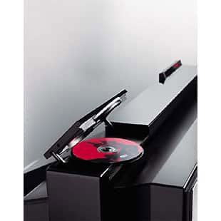

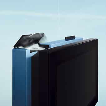

Watching movies should be about simple entertainment, not complicated technology. That’s why the Avant is available with its own built-in DVD or video recorder. Its presence is only given away by a discreet lid on the front. All cables are hidden in the back of the set.

A red LED display on top of the cabinet gives you a discreet status of the source you are viewing, without intruding on the picture. It also shows the volume status when you adjust the volume level, and other information related to recording, Dolby Surround and so on. On the back of the display is a hidden push button panel for the most frequently used controls.

A discreet display on the upper right hand corner of the Avant lets you know what source is playing and a small control panel placed behind it offers hands-on control of all basic functions.

BeoVision Avant comes as one integrated unit. All you have to do is to plug in the mains and the antenna and you’re ready to watch. There are no other visible cords, allowing the Avant to be viewed from all sides – so it does not have to be set up in a corner or next to a wall. It fits nicely into any kind on home, thanks to the range of many available cabinet colours: pearly blue, pearly black, pearly red, pearly green and silver.
