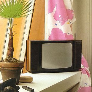

BeoVision 7802
BeoVision 7802
Beovisions that put the future at your fingertips As yet, none of us still need 32 terrestrial TV channels, let alone 100. But satellite re-broadcasting systems and cable TV, including regional and community networks, may change that. Bang & Olufsen, in the mid-1980s equipped all their luxur [...]
Bang & Olufsen, in the mid-1980s equipped all their luxury Beovision models with an advanced digital tuner that had the capacity for receiving 100 UHF channels, 32 of which could be stored in the set’s microcomputer memory for instant recall at the touch of a button.
The real boon for most viewers is that you could locate, store and recall any of these stations without leaving your armchair. All you had to do was to touch a key on the Beovision Video terminal. So although B&O gave their “future-safe” luxury TV range more micro-electronics, more features and more connection possibilities than ever before, they had, at the same time, made all this complex technology even more accessible – instantly. To borrow a phrase from the computer industry, Bang & Olufsen’s ’02-Series’ TVs were “user-friendly” (1983 catalogue).
In 1985, to celebrate Bang & Olufsen’s diamond anniversary – 1925 – 1985 – a special edition of Beovision 7802 was released. The television was finished in a dark veneer (ivory-coloured) in place of the standard teak and rosewood finishes.
A small ’emblem’ was included on the top right-hand side to commemorate this special occasion.
