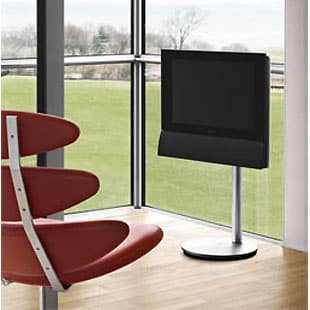

BeoVision 6 – 22 is an LCD 16:9 TV set introduced on 10 November 2003. It is fitted with a 51cm (diagonal) LCD screen which is coated similar to the Avant. Active speakers are positioned at the base of the monitor, similar to the MX range of television sets. The rear of the unit is curved, similar t [...]
BeoVision 6 – 22 is an LCD 16:9 TV set introduced on 10 November 2003. It is fitted with a 51cm (diagonal) LCD screen which is coated similar to the Avant. Active speakers are positioned at the base of the monitor, similar to the MX range of television sets. The rear of the unit is curved, similar to that of BeoSound 1.
The unit is available in one colour only – Black – and is primarily designed for link-rooms: i.e. as an extra set for the kitchen or bedroom.
BeoVision 6 – 22 may be fitted with a motorised base which turns the set and also regulates the inclination. Standing possibilities include a low floor stand similar to BeoVision 5, wall bracket or a high floor stand high (as with BeoVision 1).
This new LCD TV can be used as a PC monitor, too. When watching normal TV programmes, ‘TV’ on the Beo4 is selected; however, by combining the BeoVision 6 to your PC as a monitor via the rear-mounted DVI socket (see further details at BeoTech) and selecting ‘PC’ on the remote control, BeoVision 6 may be used in conjunction with your home computer.
In 2004 BeoVision 6-26 was introduced to complement this 51cm model.

Mounting Options & Stands
The tilt table mount was available for counter top mounting, designed to allow the bass port on the underside of the TV to ‘breath’. Motorised floor and table stands were complimented by a wall mount bracket which gave manual tilt and turn
