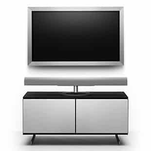

BeoVision 4 offers greater flexibility and modular convenience to Bang & Olufsen customers than has previously been possible. BeoVision 4 is available in different sizes and consists of the screen, BeoSystem 2 and a cabinet. BeoSystem 2 is the master unit having the same functionality as BeoVisi [...]
BeoVision 4 offers greater flexibility and modular convenience to Bang & Olufsen customers than has previously been possible. BeoVision 4 is available in different sizes and consists of the screen, BeoSystem 2 and a cabinet. BeoSystem 2 is the master unit having the same functionality as BeoVision 5.
The recommended centre channel loudspeakers are BeoLab 4000. This plasma TV set has been previously only available in the North American market including Canada, Mexico and the US. When combined with speakers and stands, BeoVision 4 becomes an integral part of BeoSystem 1. However, from Spring 2004 the system – known as Beosystem 2 – arrived in Europe.
This European system incorporates different-sized screens and may be mounted on a wall. Available in 50″ and 65″ screen sizes (37″ and 42″ screen sizes available only to March 2006) The screen surround is of brushed aluminium and is based upon much the same design as BeoVision 5. VisionClear and an anti-reflection coating is included. Controlled by Beo4, the system comprises:
Dolby Digital Surround Sound Decoder
Set-Top -Box Controller
Picture-in-picture
MasterLink module
HF Modulator
Cabinet 2168 is similar to cabinet type 2164 and has a shiny, aluminium-coloured front. Within it can be placed a satellite decoder, DVD 1 and/or Beocord V8000, if these are your required options.
