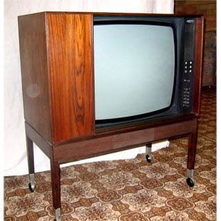

BeoVision 3200
BeoVision 3200
Type Number: 3613, 3614, 3618
Release Date: 1970, 1971
Picture tube: 26-in. A 65 – 120 X
Dimensions W x H x D: 74.7 x 85.7 x 57cm
Weight: 55 kg
Voltage: 200 – 220 – 240 V
Frequency: 50 Hz
Power consumption: 330 W
Tuning: VHF (bands I and III), channels 2 – 11, or UHF (channel 21 – 70)
Sound
Power output: 3.5 W at 10 % distortion
Distortion: less than 1 % at 3 W
Speakers: one forward-facing speaker in undercarriage, full tonal range; one side-facing mid-range and bass speaker
Tone control range: bass +/- 12 dB at 100 Hz
Treble: +/- 12 dB at 10,000 Hz
Sound detector: ratio detector
Sound intermediate frequency: 6 MHz – 2 stages
Connections: Inputs VHF aerial, 75 ohms unbalanced
UHF aerial, 75 ohms unbalanced
Outputs: extension speaker, 3 – 5 ohms (switching feature provided in speaker socket
Connection of a tape recorder requires installation of a Type 3031 transformer
