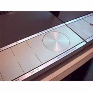

A thoroughgoing 'black box'. Nothing in the shape of the device revealed how it worked or what it was. Only the inscription on the top of the unit told the user just how the black 'magic mirror' was brought to life so it could show which function has been activated. The unit was Bang & Olufsen's [...]
A thoroughgoing 'black box'. Nothing in the shape of the device revealed how it worked or what it was. Only the inscription on the top of the unit told the user just how the black 'magic mirror' was brought to life so it could show which function has been activated. The unit was Bang & Olufsen's first remote-controlled hi-fi system.
