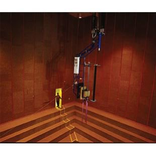

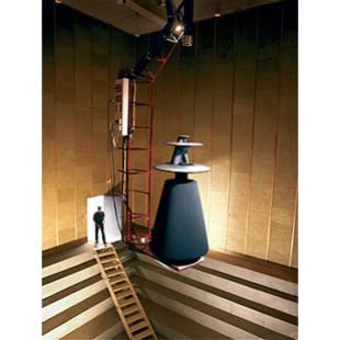

In pursuit of perfection, Bang & Olufsen uses its highly sophisticated research facility: in a purpose-built cube-shaped test chamber (12 x 12 x 13 metres) are analysed the speakers' performance under simulated free-field conditions. The test equipment and computers that are used are capable of registering even the most microscopic deviations from the ideal that has been chosen and every detail of the large number of factors affecting the sound quality of the speaker is able to be measured.
The Cube was designed and built in 1981 and is completely isolated from its surroundings. The large dimensions allow reliable measurements to be taken all the way down to 30 Hz at 1m, or 40 Hz at 3m. This is much lower than in conventional anechoic rooms, but Bang & Olufsen considers it necessary as measurements at low frequencies give a better correlation between objective and subjective assessments. The Cube is not, however, an anechoic room, but has been designed to produce a natural sounding semi-reverberant environment such as would be found in a normal home.
The loudspeakers under test can be placed to within a millimetre, tilted, or rotated to any required angle by computer control. This is a powerful tool for identifying cone break-up modes, cabinet resonances, poor suspension and diffraction effects.
