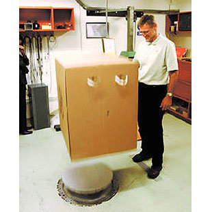

Televisions thrown around
50 centimetres: that's the drop a TV set from Bang & Olufsen - in its package - must be able to take without blinking before it arrives in somebody’s sitting room.
"We simulate one of the traumatic events a television set may encounter on its perilous journey from the factory to one of the subsidiaries, a dealer’s showroom or a domestic viewer," says Torben Jørgensen. "There is ample opportunity in that process for somebody to drop it and if it can’t take the shock, then it doesn’t go anywhere."
A heavy set has a lower drop-height than its lightweight cousin. "This has nothing to do with the punishment the two sets can withstand. It’s simply a question of how high they can be lifted and you don’t lift a heavy set as high as a small one."
Bang & Olufsen’s Hi-Fi sets, however, have to take the real rough stuff. A 10kg set has to take a drop of 86cm. And just to be on the safe side, 30cm is added to the specified tolerance limits. They are dropped onto the tops, bottoms, sides and corners.
Torben Jørgensen adds, without a trace of sadistic pleasure, that other Bang & Olufsen equipment, including loudspeakers, is subjected to the same unkind treatment.
