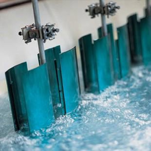

While the chemical anodising process remains the same for all applications, the mechanical methods vary according to the two physical types and shapes of metals used.

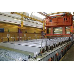

Batch Anodising involves racking parts and immersing them in a series of treatment tanks. In wider industry, extrusions, sheets or bent metal parts, castings, cookware, cosmetic cases, flashlight bodies and machined aluminium parts are just a few of the items that are batch anodised.

Anodising is accomplished in five carefully controlled, calibrated, quality-tested stages:
Cleaning:
Alkaline and/or acid cleaners remove grease, and surface dirt
Pre-treatment:

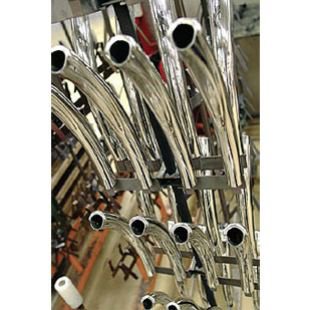

(a) etching. An appealing matt surface finish is created with hot solutions of sodium hydroxide to remove minor surface imperfections. A thin layer of aluminium is removed to create a matt or dull finish (b) brightening. A near mirror finish is created with a concentrated mixture of phosphoric and nitric acids which chemically smoothes the aluminium's surface
Anodising:
The anodic film is built and combined with the metal by passing an electrical current through an acid electrolyte bath in which the aluminium is immersed. The coating thickness and surface characteristics are tightly controlled to meet end product specifications

Sealing:
This process closes the pores in the anodic film, giving a surface resistant to scratching, abrasion, crazing and colour degradation.
